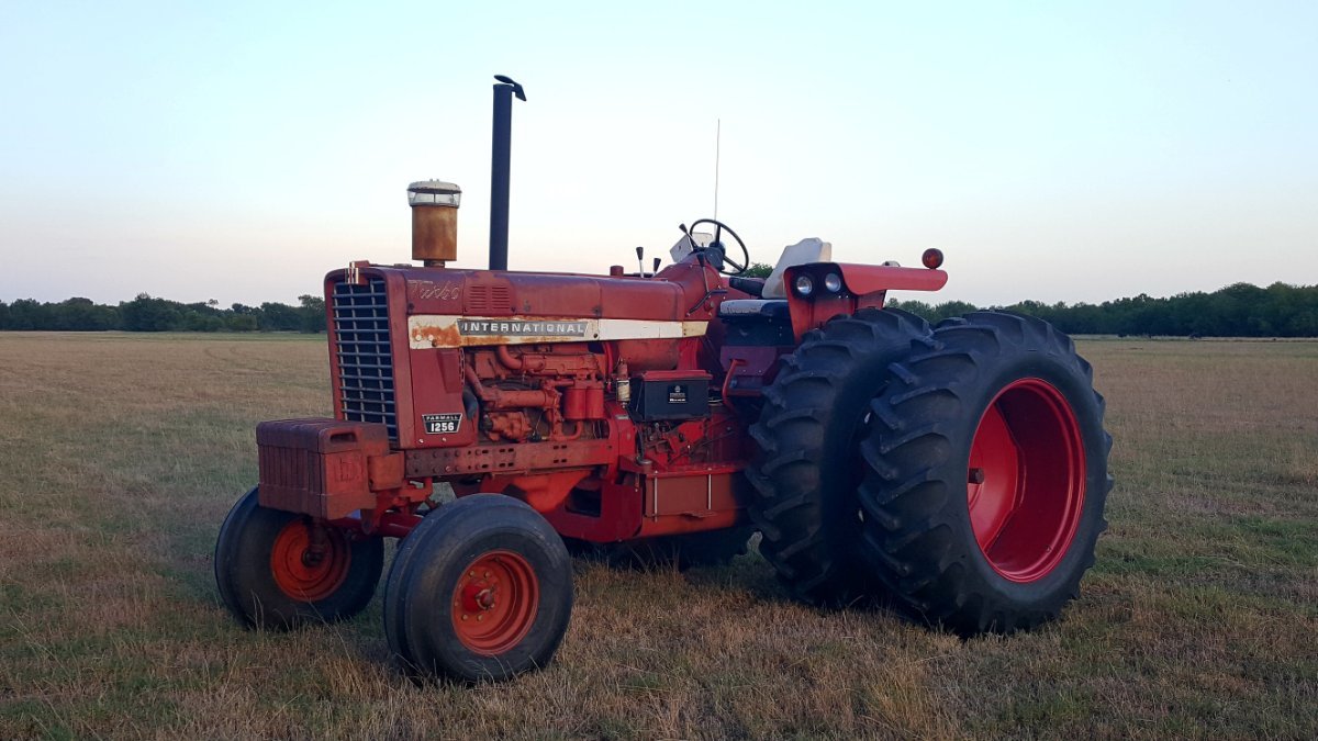

  1. Worked some rough ground. Disked 3x and cultipacked. Disked and smoothed out cow trails. Added some jewelry to a 1456.

  3. Found this in Lampasas TX. More than likely it originated in TX panhandle. Factory cab, 20.8-38s and 11.00-16s. Had the 1k lbs wheel weights that come from western tractors. Even had the factory 20.8-38 duals with it. Bought it as salvage. Didnt run missing alot of hyd parts. Guy i bought it from sold it to an old man 10 years ago, old man ran it, 3pt quit, he took it all apart then died. Alot of parts were lost or stolen. Widow sold it back to guy i got it from. Got it running day i got it home, got 3pt working shortly after. Guy took it all part and all it was, was a sheared key on hitch pump gear shaft. Front axle is welded up with center pin bushing housing broke out.
  4. HD rear axle option. Has HD bearing carriers. Should also be 114" axle width. I think they were also the same housings used for high crops. Came out prior to the 118" axles.
