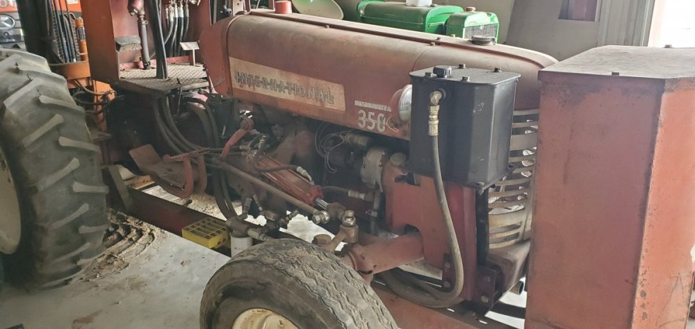

    I've modified the jerryrigged steering again since the photo. It had too much leverage on the spindle on my first build. Originally it was a hyd torque generator that was hooked to the steering shaft via a chain, terrible system. I also installed a mast from a toyota lift and made a fork positioner that works off the side shift circuit. The power steering operates off the tractor pump and the mast pump off the front of crank. The main reservoir is in front of the operator where the controls attach. It's a pleasure to operate but very thirsty.20200324_153508.thumb.jpg.883aaf79b027db9370fc5ddde89fac65.jpg20200324_153456.thumb.jpg.ef060f0c82fbc763e1646f81189ef5a4.jpg
