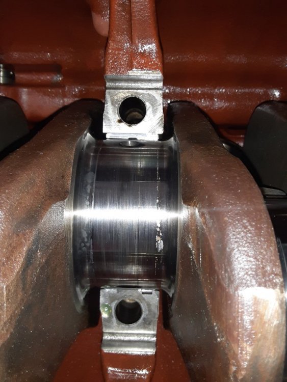

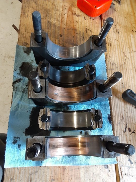

  3. Found sludge in oil pan, Do you think #4 main starved for oil? it supplies #4 rod which looks like was getting hot also included a pic of #4 upper main. Crank looks like it should polish out.
