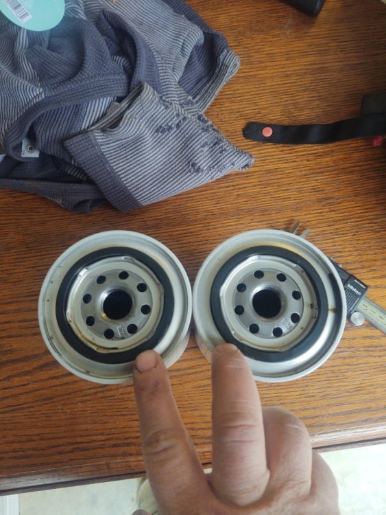

  11. I'm guessing thats what happened. Oil filter housing on IH 400 series is 1"-12 thread. I'm wondering how many cases of these filters got these wrong thread base plates.
  12. Son was changing his oil filters on his 1066 today and he told me the oil filter wouldn't go on and the hole was wrong size. I went to look figuring he was having an issue starting the threads and told him there is no way a 3316 filter could have the wrong hole. Well this is a first for me, 2 brand new 3316s straight from the dealer last Tuesday have 3/4" threaded holes in them rather that the 1" hole that it should have. Anyone else ever seen this?
