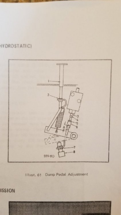

Thanks Binderdan. I'm pretty sure this has the Hydrostatic transmission. In the service manual, (I have 2) it states and shows the safety switch (electric signal allows starter to get power) must be engaged. I have made it this far, my new starter engages. The problem I'm having is disengaging the hydrostatic transmission from the engine. Where dose the hydraulic pump get its power? Electric? PTO mechanical from a running engine? In the diagram, notice the hydraulic high pressure box up and to the right. -

Ok guys this engine has yet to turn over for me. I think the "dump switch" i.e. the safety switch is not disengaging the engine from the transmission. The electric part of the switch is doing its job, the starter will crank...but I only get the "thud". Flywheel will not move. I hooked up the battery again today to play around a bit. Behind/under the key switch, this disentigrated (see photos) first two, looking at my manual I can't determine what it is. It looks like a starter solenoid? There are 2 other "blocks" that were disentigrated too, they look like some type of voltage regulator. You can one of them to the left of the "? Starter solenoid?" The third picture is some type of switch, not sure what switch and the other end of the red wire (heading to the front of the tractor it is not attached to anything. Don't see where is would go either. Don't see it in my electric schematic in my manual either. -

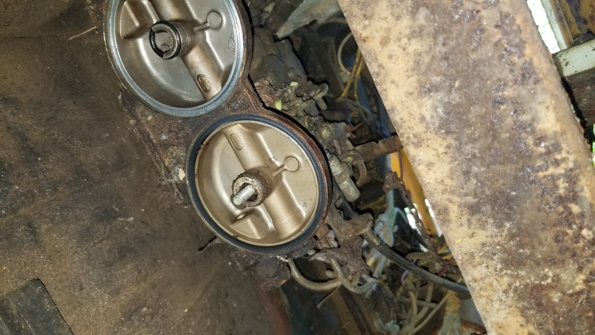

Ok guys, I pulled the fuel filter assemblies off. The glass bowls were chipped, cracked in different spots on both. I think you can still get replacements from yesterday's tractor and a few other places. Is there a more modern easier upgrade? What do you guys make of the photos? Something looks askew on the 2nd one (silver). -
