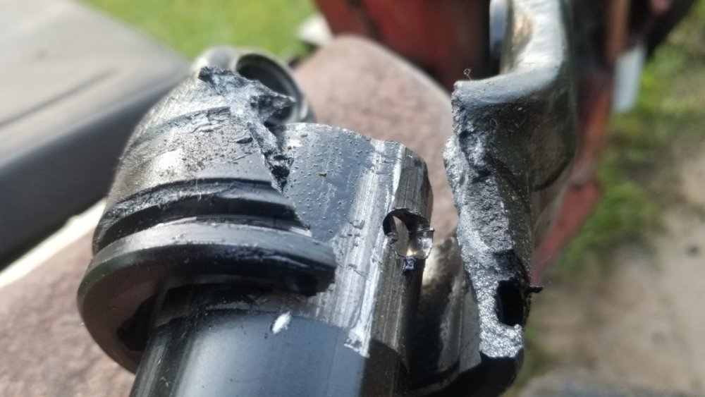

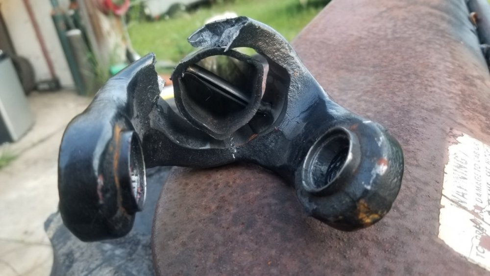

  1. UPDATE ---- I took all my busted pieces to a local driveline shop here in my city. owner who looked at it said what I have is China-made knock off of an Italian PTO shaft design. The china metal used to make the yoke is a substandard casting and porous metal -- broke easily. =============== photos show failed yoke. and the place in my field where it failed. 45 HP tractor with a 5 foot cutter running at about 1500 RPM into a rise in the dirt while mowing the grass. No stumps within 100 feet of the failure site - cross my heart. I'm 56 years old and around tractors all my life. I think I know use vs abuse and I really was not running it hard. Surprised at this kind of failure, even from a budget-priced overseas part. Internet retailer in GA told me to pound sand, they don't sell junk, etc etc. Am I expecting too much ?
