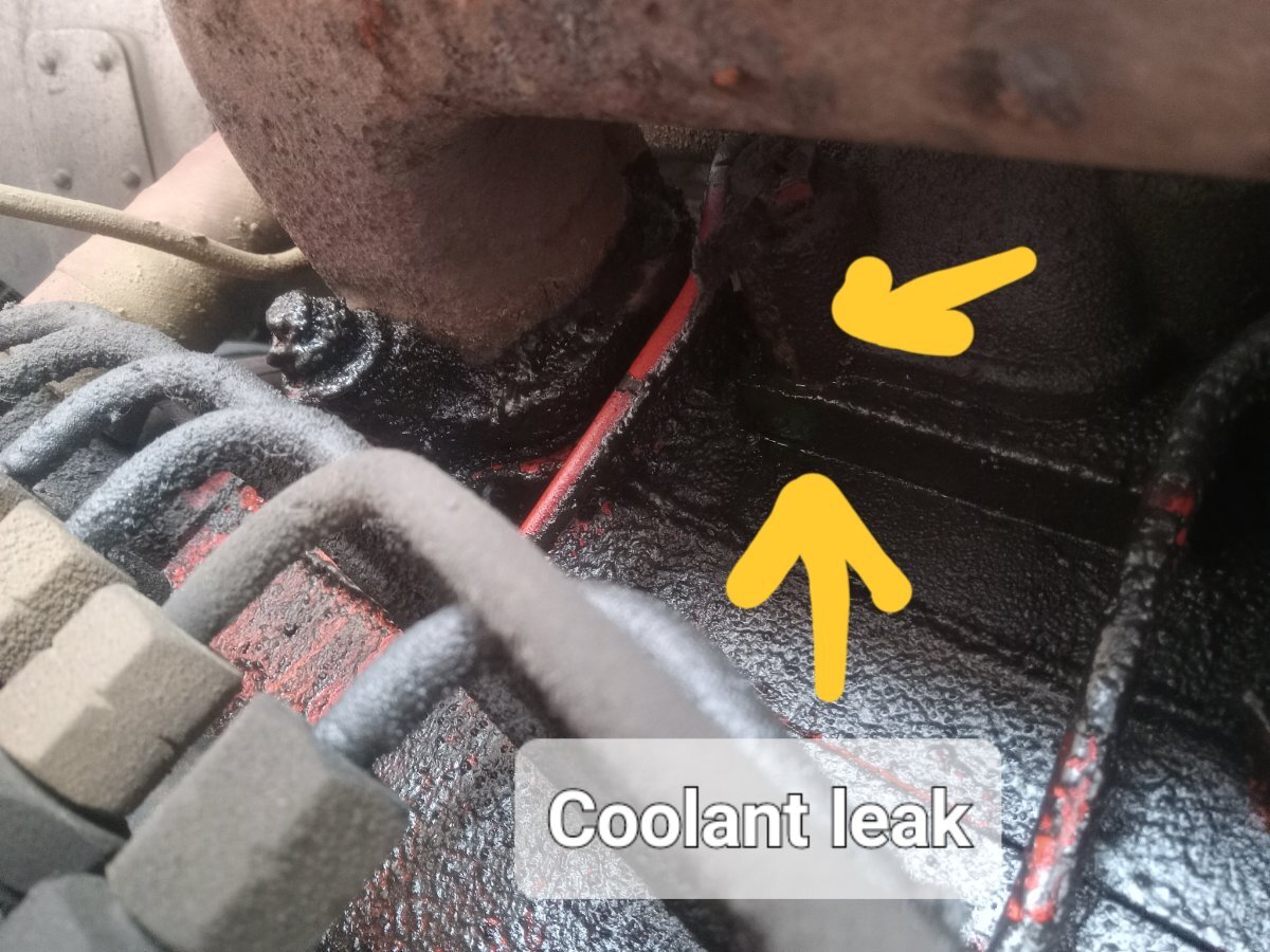

I'm hoping not. That location I took pics of that coolant leak. Above it is the mufler. That's where I saw a couple puffs of black smoke coming out below the muffler. So if coolant leaks on hot exhaust manifold. Sure it doesn't smoke black?? I was back in the fields field cultivating a strip of untilled fields back and forth with no problems. -

I figured what caused smoke underneath the muffler. There's coolant leaking from the coolant manifold that connects the top radiator hose. Is there a way to patch it without taking it out?? -

The exhaust manifold is cracked in the lower center. I used exhaust manifold tape to patch it as much as I can. -

There's no black smoke coming out of the muffler when observing. Underneath coming out below the muffler yes. -
Questions. I was field cultivating a landowners 13 acres of corn snubs at 4.5 mph at 1800rpms. 3 hrs later I saw a couple black smoke coming underneath the mufler. Is the fuel injector getting too much fuel in one of the cylinders or is it coolant leaking down to the manifold that could cause black smoke?? I let the tractor idle down for a few minutes and it ran fine until I finished tilling and putting it away. What do you guys think??
