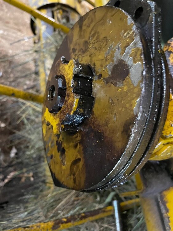

  1. I am trying to change the slip clutch friction plates on a Vermeer 605D baler. I was able to unbolt the gearbox side collar, and the various plates in the slip clutch can move toward the gearbox. I am hoping someone can help me with directions to remove the front collar on the PTO shaft. I have attached a picture. Does anyone have an idea how to pull the collar off the shaft. Thanks for any help. Dave
