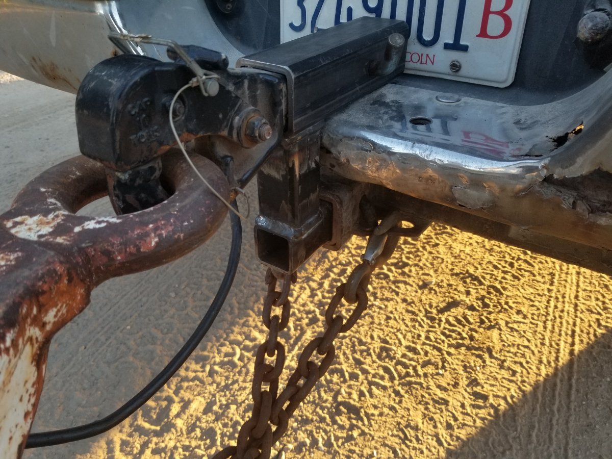

    Going to finish up this thread with completion of this air compressor hitch weldment. All is fine and I stuffed another tube into the bottom tube for strength as it will bear most of the brunt of the pull. I did do the same to the vertical riser but did not photo that. I'm comfortable it will serve the purpose. Double tube install: Welded up solid and smoothed out both ends: Used existing holes as pilots and the pins go right through: Nice little project and I really enjoyed doing something for myself this time: I'll blast this clean and get some paint on it the beginning of the week so it will stay somewhat rust free. It will only be used when I pull the air compressor but may find use on down the line when I build a heavier trailer.

    Back on it's wheels again. I spaced the axle stubs into the tubes with .250" shoulder stickout to allow weld bead buildup and strength: You know the saying about a job done right so I packed the bearings myself this time: Getting close. All put back together and bolts cinched down. Getting ready to drop unit close to floor to hang tires. Here is weight on wheels: Hitched up the truck and went down the road for a spell to wear things in. I then retorqued the lug nuts and calling it good. However, tiring of the "nose down" attitude of the compressor when pulled with my pickup, I decided to build this to elevate the tongue to level and it seems to work well: Tomorrow I'll insert this tube into the larger tube for additional strength and cap the end closed: I like it a lot better than the original:

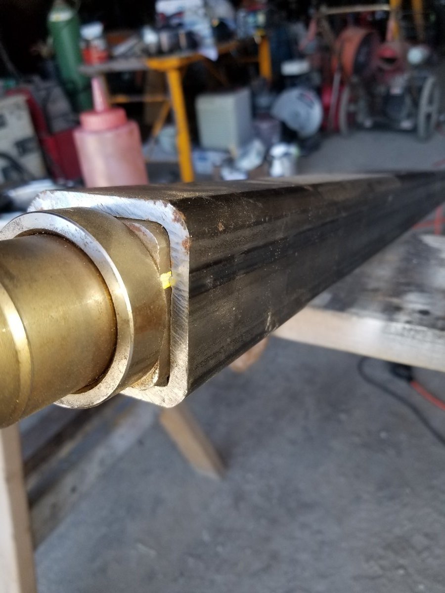

    2.50" square by .250" wall C1045 steel tube which is much stronger/tougher than C1018. I don't know what the spindles are machined from. Typical of tube that is not DOM there is an internal weld seam from the manufacturing shown here at the right side of the tube interior: This is one of the replacement spindles which needs to slide into the interior of the tube: As can be seen in the photo the weld bead precludes this spindle sliding into the tube. A little measuring and grinding a slot with a "Zip" wheel and it slides in easily with minimal force. Alignment is good also: Did some measuring to allow a 1.00" clearance from the tire sidewall to body and this fit well having the tire tread centered in the fenders as original: Overall pretty happy with the task but it's been tough fitting it into the schedule. The blasting business is growing faster than originally anticipated. Seems with the economy in the tank as it is folks are electing to rebuild and repair older equipment rather than replace if a replacement is available. Myself attempting to specialize in mobile, (away from my shop) blasting seems to be a large draw. I have several antique tractors and implements on the docket to get to this summer.

    Auger:
    Not a bad little repair and all fits and aligns as it should with weight on wheels:
