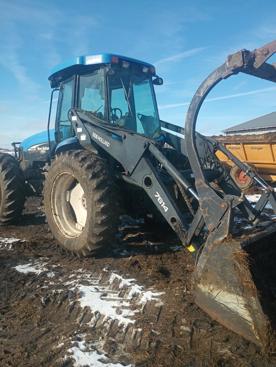

New Holland tv-145 Bidirectional. Having issues with shift solenoid getting the proper voltage. Sent the dash computer to ag express they said not repairable. Found the only new dash eic available in new Hollands dealer network. $3,000 plus shipping. Got dash today and it has 2,466 hours on it and doesn't supply the shift coil with the proper voltage. I'm have no ideas where to continue. So I'm wondering if anyone could help me. I do have the service manual. All 2,000 pages. I've identified lots of things and have traced it to the eic not putting out the proper voltage to shift coil. In the attached picture it shows the volts and amps for the 3 ranges. How can I make something to supply the right volts and amps? Im at a loss. The max speed I can get out of it is 6.1 mph with the old eic dash. The "new" one will not shift it out of range 1.
