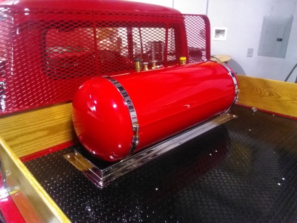

  1. 5/25/22 I visited ,"Herb the flat bed", today and drove it for first time and hearing it run was great! very pleased ! It’s at upholstery shop in picture , he told me, "done by end of next week with Upholstery", then back to IH parts America for final adjustments and painter for touch up and final polishing . planning on it home by first of July tony couple pics

  3. Mufflers and extensions and heat shields came from Devon’s tractor parts , Indiana. I had them ceramicoated and Shields were chromed . I had to make most of my brackets , bolts spacers , then chrome them tony

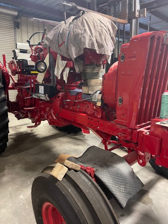

  14. 4/18/22 806 LP engine not good ! Here we go again if you read back this engine has been through machine shop twice , head three times , hunting down slight valve miss and slight engine knock . Original machine shop rebuilt it first time all was standard we got her going on Dyno and it seized took he apart and it appears to be a reliance quality problem . Machine shop redoes engine but has to bore .30 to clean mess and .20 on crank . Back together and still same miss and slight knock . Put 10 hrs on engine starts a hounding noise like a broken valve spring . Shut her down , Sat for seven months because of my illness all winter . now getting stronger we finally pull her down all springs valves rockers where they need to be , we pull head take to an old Time Machine shop 80 year old tech looks at head says it looks like new turns her over poors solvent on valves seats they all leak come to find out they were never lapped. we pull pistons they look good but more light scoring of bearings coating more then one would think Clean all , Mike crank and bearings put together . We cured the valve miss but the engine sounds like a bucket of bolts rattling around. The experts are telling me piston slap due to bad boring . can’t yell at original machine shop ,owner died ! I am going to find a good 301 block and start over a use 80 year old Mike to machine and put together and find other pistons rather the reliance. tony
