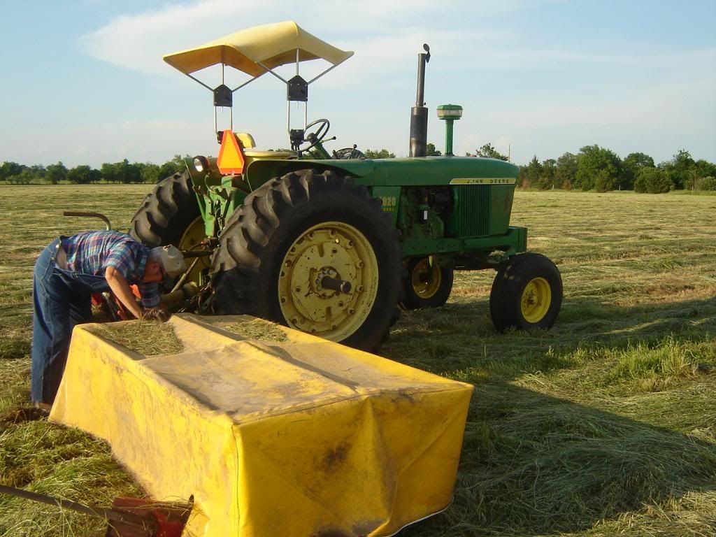

I"ve always run a 3pt mounted disc mower on an openstation tractor. It sucks if you hit a red ant bed but other than that the canvas keeps most deris from kicking up. I prefer to run a disc mower on an open frame so I can hear the mower run better and I like to hear the engine run. If it does become a pronlem and kicks up too much deris towrd the operator. I've seen numerous ways farmer/ranchers have made a screen to mount on the right fender. Ive also seen rocks bust out windows on a cab tractor too.

Will I need a stone shield if I say that is a nice looking 3020?

I bought a pull-type NH discbine last year and ran it with my 1256 (seen to the left) and lived to tell the tale. i pretty much know where the rocks are in the fields and tilted the head back a bit to keep from catching them. a cab would be preferable, though, and i agree that a good canvas is a must.
looks like a 4020 to me? nice looking tractor indeed

I stand corrected (But I could have blamed former President Bush)
