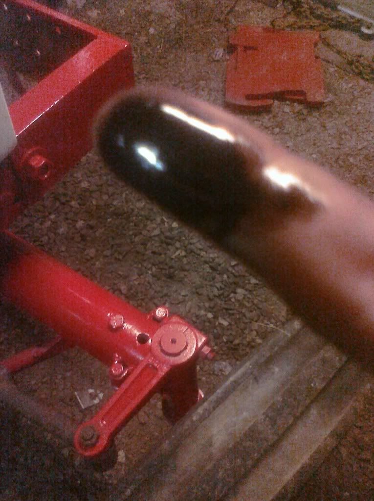

I took the pipe off the manifold and rubbed my finger on the edge to show how much oil it is spitting out.

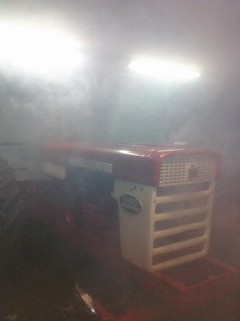

And this is a picture of just cranking the tractor really quick, I was going to start it and crack the injectors lines but it was just too smoky to do in the garage.

Our 886 has the 358 in it. I notice it would "slobber" from the 1st and 2nd port of the exhaust manifold. This only seems to do it when it is running the auger at idle or 1000 engine RPMS and more in the winter. It was more fuel and condensation than any oil since it would come out thru the gasket.
Your case is way different than the slobber issue we have had. It always starts really quick. Sometimes it sounds like its chugging along at first then speed it up some and then is smooth.
If it is oil coming out too, you should see a difference in the oil level. That is puzzling. Unless diesel is filling in the pan.
See about pulling an injector line at a time to narrow it down to a specific cylinder.
Also I'm not sure how the pump is setup for lubrication, but could there be somehow oil could get in the fuel injection side? I'm probably wrong on that, but hopefully someone else will have the right answer.
