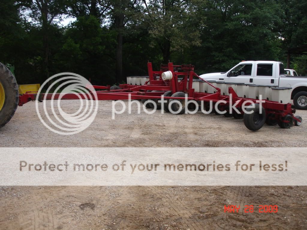

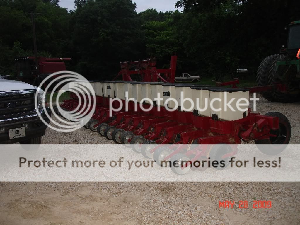

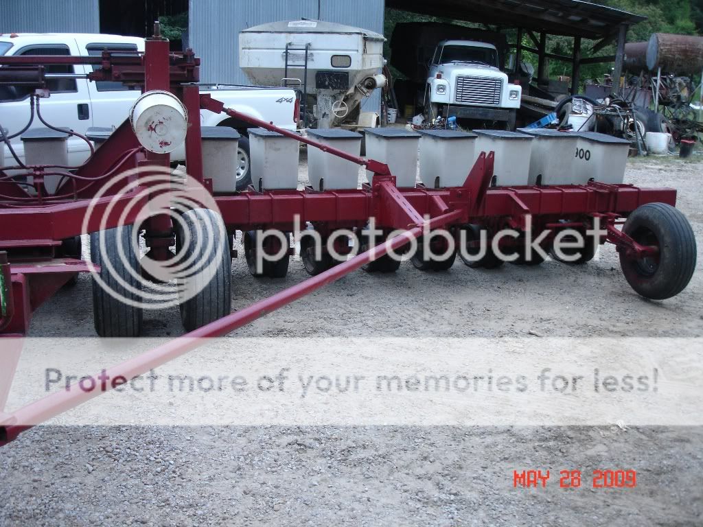

800 and 900 plate planters are very common around here. I have a 6 row, neighbors have a 6 row. Saw 4 900's at a sale last weekend of different sizes.
Posted Image
Posted Image
Posted Image
Posted Image
Posted Image
Posted Image
This is a picture of one a friend of mine built using a great plains 30 ft drill caddy and 2 ih tool bars. These are the central drive type units and there is a transmission on each bar. They've only planted beans with it the last 2 years but are probably going to plant corn this years also with this planters instead of their 10 row 7100.
