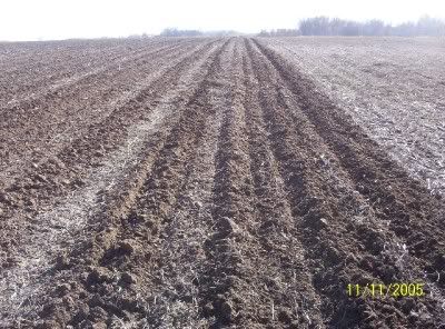

Here's my two cents on rippers and points. Take them for what you paid for them. Also, I've done quite a bit of digging behind DMI, Blue jet, and our Brillion ripper.
The Blue Jet is a good ripper, I think they're built all right.
However, the way they work, is that they fracture the soil structure horizontally all through using a wide point. In a high clay content soil like we have here, with freeze thaw/shrink swell, and rain compaction, the soil just tends to settle right back down on itself. Lot's of guys around here have used them in the fall, and by the next spring you can't hardly tell where you've run one.
The Brillion shank is a verticle tillage type of shank. It makes a narrow slot at the bottom, and v's out till it essentially blows out an 8 to 12 inch zone at the top of the ground. This will be a humped up zone, so it's less dense than the soil around it. When this zone swells then, it tends to blow the surrounding soil apart, further reducing compaction, rather than just letting it settle down and recompacting. I can still find ripper slots in our soils that are 3-4 years old. You'd never find that with a low disturbance horizontal fracturing ripper.
The picture here is without the firming baskets on. If we pack it down in the fall with the firming attachment, you will have a trench come spring if you get a lot of moisture over the winter. Beleive it or not, come spring you can no-till into this. It's a bit rough, but not undoable at all.
